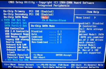

לגבי ההגדרות שציינת, איפה אני משנה אותם ?
לא יודע, יש הרבה סוגים וגרסאות ביוס.
זה יכול להיראות כמו כל אחד מאלו:
images?q=tbn:ANd9GcRGb7Y8GHHXFJhbWIjt9Hugf48DX8l8UWucR9ZT11ZS-MfVTeRcLw

אני לא בטוח מה צריך לבחור
נערך על-ידי jaxx
Your mobo, according to page 42, offers the choices through the SATA configuration options under the Integrated Peripherals ... On-Chip SATA Mode menu. The first, "Disabled", is to Disable all SATA ports (so you have only 2 IDE devices on one port); the last, "Non-Combined", Enables all SATA ports (making them into Emulated IDE devices) and Disables the real IDE port.
Enhanced mode allows all four SATA ports to be used in native SATA mode, in addition to the 2 IDE devices. So you could hook up max 6 devices (2 IDE plus 4 native SATA) BUT this option means you have to load SATA device drivers into Windows. The most common way to do that would be to make the IDE channel Master device your boot device and install Windows there. Then, with Windows running, you would load SATA device drivers (from your mobo's CD-ROM disk, likely). These would NOT make your SATA devices available for booting, but they would load automatically with Windows every time and allow you to use all four of them (in addition to the IDE devices on their own port) within Windows.
Combined mode is a compromise. It makes all the SATA ports act like IDE or PATA ports and, hence, imposes a limit: there can only be 2 PATA ports with 2 devices each, total of four. If you choose this mode, then there are three other options to set. "PATA IDE Set to..." chooses whether the real IDE port is the Primary (channel 0) or Secondary (channel 1) port, in each case allowing a Master and a Slave device on the port's cable. The disabled option here seems to be the same as choosing the "Non-Combined" option earlier. The next two options (actually, looks like they may be automatically set) show that the Emulation scheme they use is this: SATA port 0 is used for the channel 0 Master, SATA port 1 is the Channel 1 Master, SATA port 2 can be the Channel 0 Slave, and SATA 4 can be the Channel 1 Slave. So, in "SATA Port 0/2" we find that, IF you chose the have the IDE port as Channel 1, then SATA 0 and 2 are active as Channel 0 ports, Master and Slave respectively. On the other hand, IF the IDE port was set to be Channel 0, then SATA ports 1 and 3 get to emulate Master and Slave on the other IDE channel, #1.
נסה COMBINED, אם זה לא יעבוד נסה ENHANCED.
אם הבעיה מה שאני מנחש שהיא, אחת מהאופציות יגרמו לוינדוס לעלות.

ניסיתי את כל האפשרויות שם, התוצאה חוזרת על עצמה. 5 שניות אחרי שעולה מסך הטעינה של ה windows המחשב מאתחל את עצמו.
אין איפשהו אפשרות שמחליפה מIDE לAHCI? אם תמצא משהו כזה תנסה פשוט ההפך ממה שהיה...
זה יכול להיות הגדרות אחרות בביוס שקשורות לניהול משאבים ע"י הביוס או הוינדוס.
אחת האופציות האלה יכולה לגרום להתנגשות במצב הפוך ממה שהיה כשהותקן הוינדוס.
